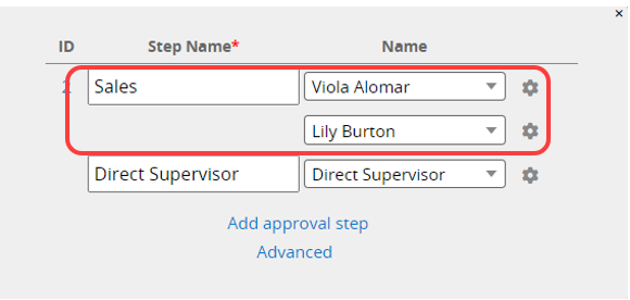

By clicking on the "gear" icon located just on the right of the approver selection menu, you can add approvers in this step. By doing this, all the approvers in this step must approve this sheet to proceed to the next approval step.
If you want users to determine the number of approvers at the same step, you can set up a Select User field and enable Multiple selection. Then, when configuring the approval process, select this field twice. This ensures that all the users chosen in this field must complete the approval step to proceed to the next one.

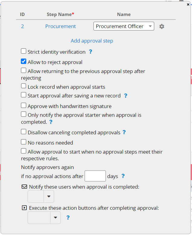

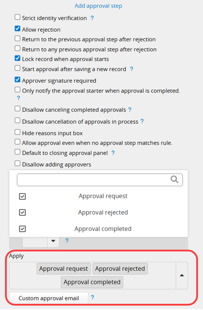

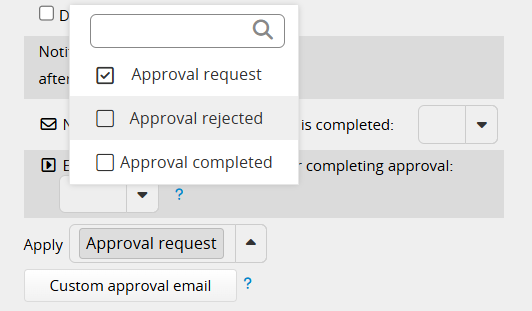

Below are some additional settings you can configure for your approval flow:
Strict identity verification: In the approval process, approvers will need to enter their password again.
Allow rejection: Approvers will be able to reject the approval.
Return to the previous approval step after rejection: Whether to allow rolling back to the previous step after rejection. When it is not enabled, rejecting will cancel the entire approval process.
Lock record when approval starts: The record will be locked once the approval process starts to prevent users from modifying it.
Start approval after saving a new record: The approval process will only start if one record meets all the following criteria:
1. No manual selection of approvers is required in any approval step.
2. Created by internal users.
Approver signature required: Users will see a signature window when approving. Once checked, users cannot approve subsequent steps.
Only notify the approval starter when approval is completed: This setting will not affect the users selected in "Notify these users when approval is completed".
Disallow canceling completed approvals: If this setting is not enabled, only the SYSAdmin, Group Administrator (who manages the group tab associated with the sheet), and users with Feature Access to cancel approvals can cancel a completed approval by default. Once enabled, the "Cancel approval" option will no longer be available after the approval is completed. The system will execute the action button using the authority of the final approver, so ensure that the user who approves the final step has access to execute this action button for it to run automatically.
Disallow cancellation of approvals in process: By default, only the approval starter, SYSadmins, Group Administrator (who manages the group tab associated with the sheet), and users with Feature Access can cancel the ongoing approval process. If you want to disallow the approval starter from canceling the ongoing approval, please enable this setting.
Note: Enabling this setting overrides all access rights settings, including Feature Access Settings. The approval starter cannot cancel the approval in this sheet, whether they are a SYSadmin or part of a group with "Cancel Approval" permission.
Hide reasons input box: the field for the approver to enter the reason will not be displayed. Once checked, the Subsequent Step Approval will be automatically enabled and cannot be disabled.
Allow approval even when no approval step matches rule: Allow approval to start when no approval steps meet their respective rules and enable users to decide whether to complete it.
Notify approvers again after pending for? days: When no approvers have completed an approval step in a specified number of days, the system will automatically notify all approvers in this step again.
Notify these users when approval is completed: You can notify any user or user group.

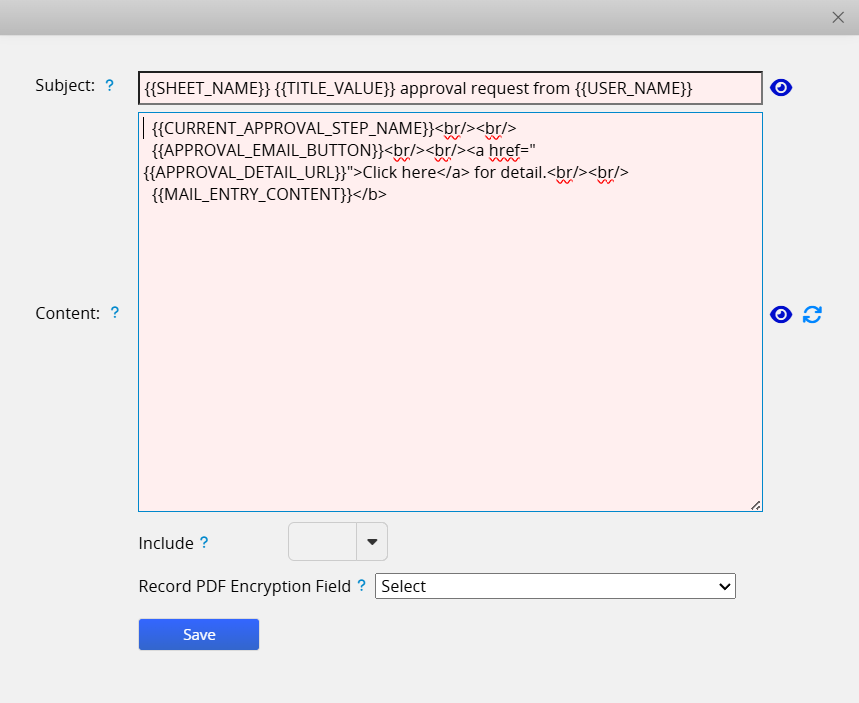

Apply Custom general approval email: Please refer to this section.

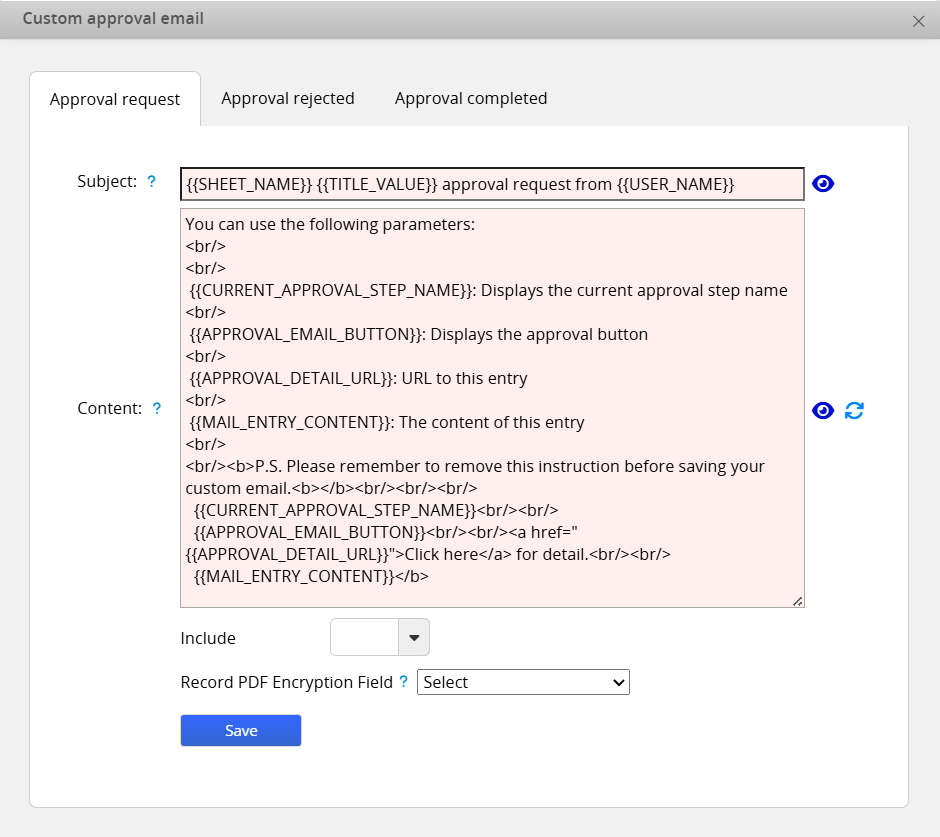

You can customize the following two types of approval emails:
1. General Approval Email: This email is sent regardless of approval steps.

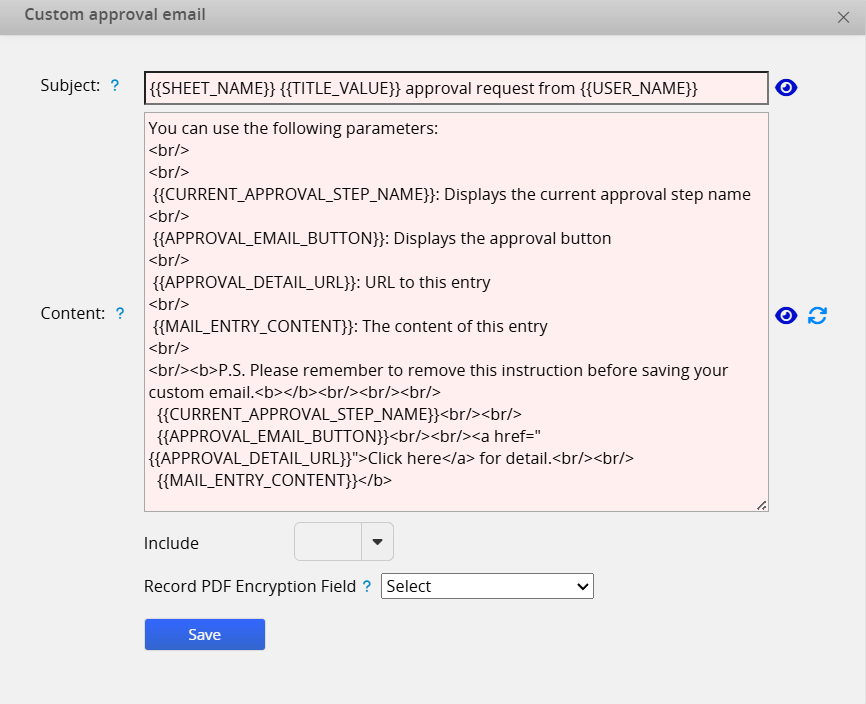

Go to Advanced Settings, check the option Apply Custom general approval email, then click the "Custom general approval email" button to configure the email content.
Note: If the option is checked but the custom email is not set and saved, the system will use the Default Approval Email.

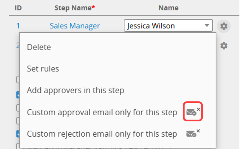

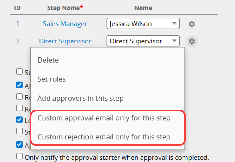

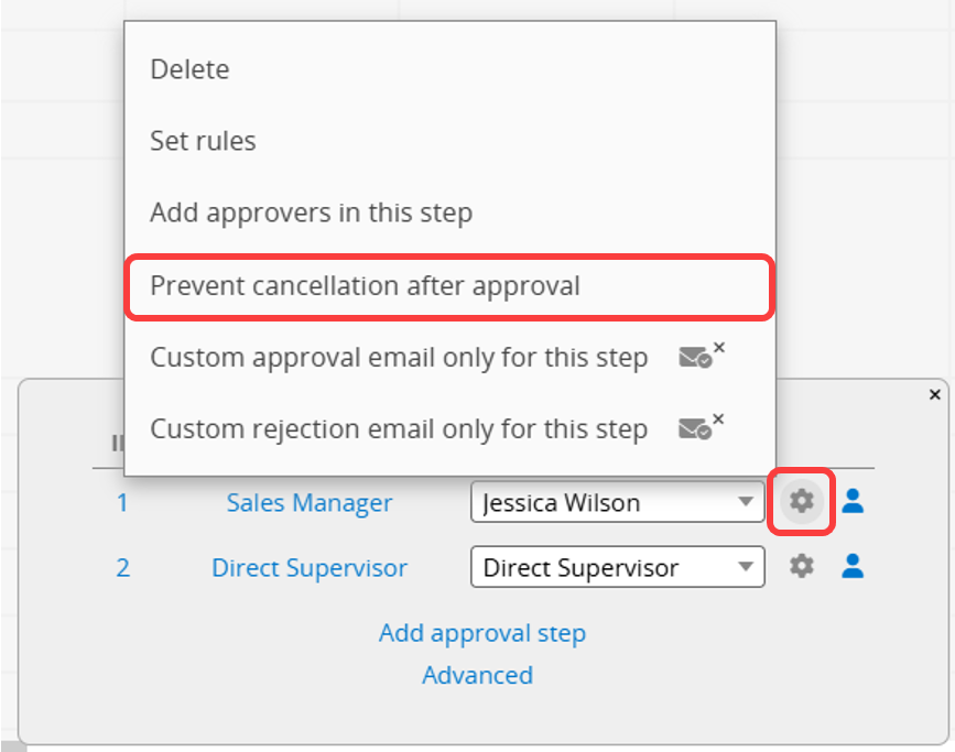

2. Step-Specific Approval Email: This email is sent for a designated approval step.
Click the gear icon next to the approval step and select Custom approval email only for this Step.
For custom approval email settings, please refer to this article.
Remember to save the sheet design to ensure the custom approval email template is saved.
After saving, an "E-mail" icon will appear next to Custom approval email only for this Step.
Once the approval process starts, the approver will receive the customized approval email.

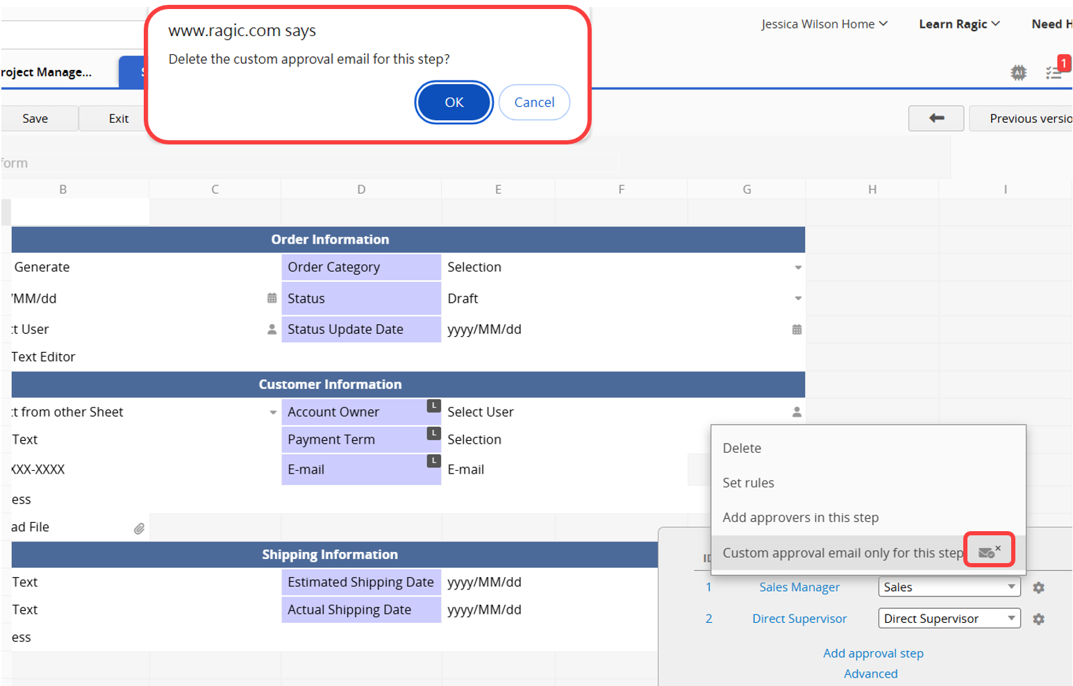

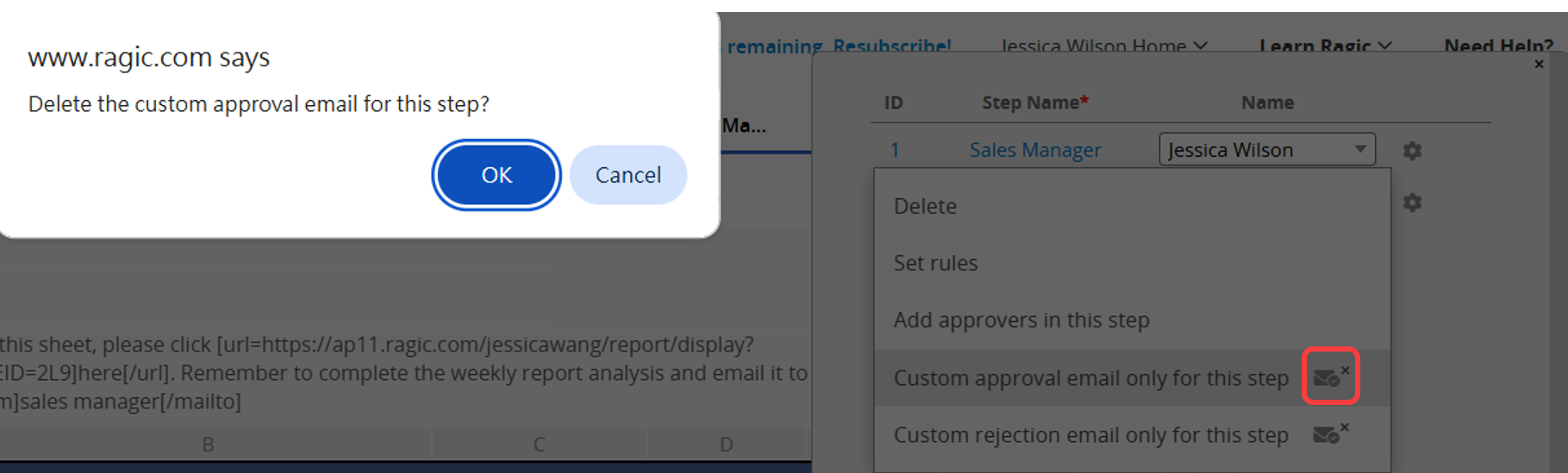

2. Add a new step before or after this step: these actions create new steps that were not originally in the approval process. In this case, the General Approval Email is sent first. If no customized email is set, the Default Approval Email will be sent.
1. General Approval Email: In Advanced Settings, uncheck the option to Apply Custom general approval email. Once deleted, the system will switch to sending the Default Approval Email.
2. Step-Specific Approval Email: Click the "X" in the top-right corner of the "E-mail" icon next to "Custom approval email only for this step" to delete the setting. After deletion, if the General Approval Email is configured, it will be sent instead. If no General Approval Email is configured, the system will send the Default Approval Email for that step.
Here are the variables for the approval process:
{{CURRENT_APPROVAL_STEP_NAME}}: Displays the name of the current approval level.
{{APPROVAL_EMAIL_BUTTON}}: Displays the approval action button.
{{APPROVAL_DETAIL_URL}}: Provides a hyperlink to the detailed content of the record.
{{MAIL_ENTRY_CONTENT}}: Displays the content of the record.
For other custom email template-supported variables, please refer here.

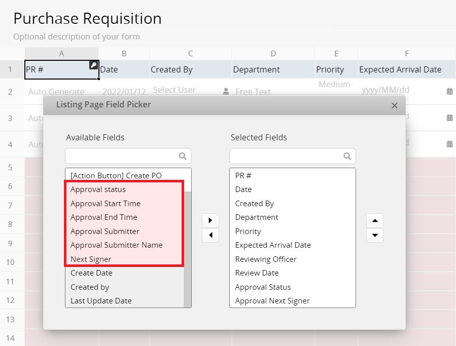

After adding an approval flow to your sheet, you can use the Listing Page Field Picker to add approval-related fields on the Listing Page.
If you add these fields on the Listing Page, they will be automatically added on the bottom of the Form Page and set as Hidden by default.
Alternatively, you may manually create fields and apply approval formulas to populate approval-related values. For example, if you would like to populate the status of the approval flow, you may create a free text field and apply the following formula.
APPROVAL.STATUS()
After saving, you can obtain the approval status of this record. You can use the Listing Page Field Picker to add new fields to the Listing Page.

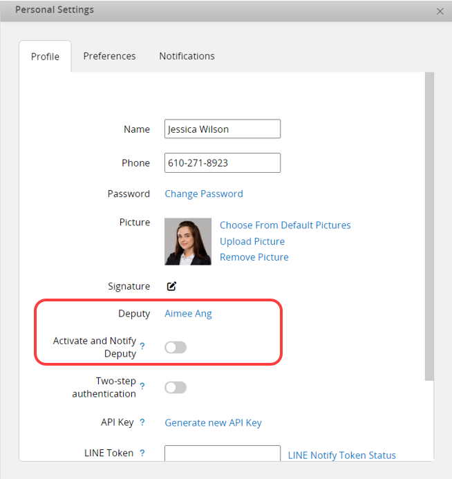

You can assign a deputy for users in the User Page allowing the deputy to approve or reject approval requests in the user's absence. For detailed information, please refer to this article.
Remember to check the Activate and Notify Deputy options on the User Page to enable the Deputy Approval feature for that user and ensure the deputy receives approval notifications and emails.
Users can enable the Activate and Notify Deputy in their Personal Settings.
If you manually click to resend the notification email, both the approver and any deputies currently set to be notified will be added as Entry Managers.
