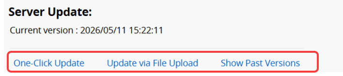

    Updating Your On-premises Server
    Before updating, ensure that all data in the Ragic folder has been backed up.
    Note: The following update methods are not supported on Windows servers. Please use manual update instead.
    To upgrade your Ragic server, navigate to On-Premises Config and use the following three methods in the Server Update section at the bottom of the page:
    One-Click Update: Update directly to the latest patch version.
    Update via File Upload: Download patch files or the full installation package from this URL, then upload the files to update the system.
    Show Past Versions: Display the latest 3 versions, allowing users to switch to a different version with one click.
    A Ragic service restart is necessary after an update, and a restart link will appear for you to restart your Ragic service. On Linux servers (including QNAP and Synology servers, they are Linux based), you can use the restart link to restart your Ragic service, but on Windows servers, you will need to kill the Java process started by Ragic and manually restart it.
    Note: "On-premises" here refers to any private server service, including self-built servers and NAS. This method is applicable for updating Ragic services. The main reason is that for products like NAS, the control over the update process is relatively limited for Ragic, and the version updates are likely to be slower than the official releases. Therefore, it is recommended to download the latest update files from the official website and use this method for updating, instead of relying on the Application Center update.
    Full Update
    In some cases, we will suggest you do a full update. Then you will need to download a full version of Ragic.
    You will need to make changes to the .sh or .bat files in the bin directory again if you have done any modifications to them. So make sure you have a backup of your old .sh or .bat file before you replace it.
    You will also need to stop the server before the update and restart the server after the update.
