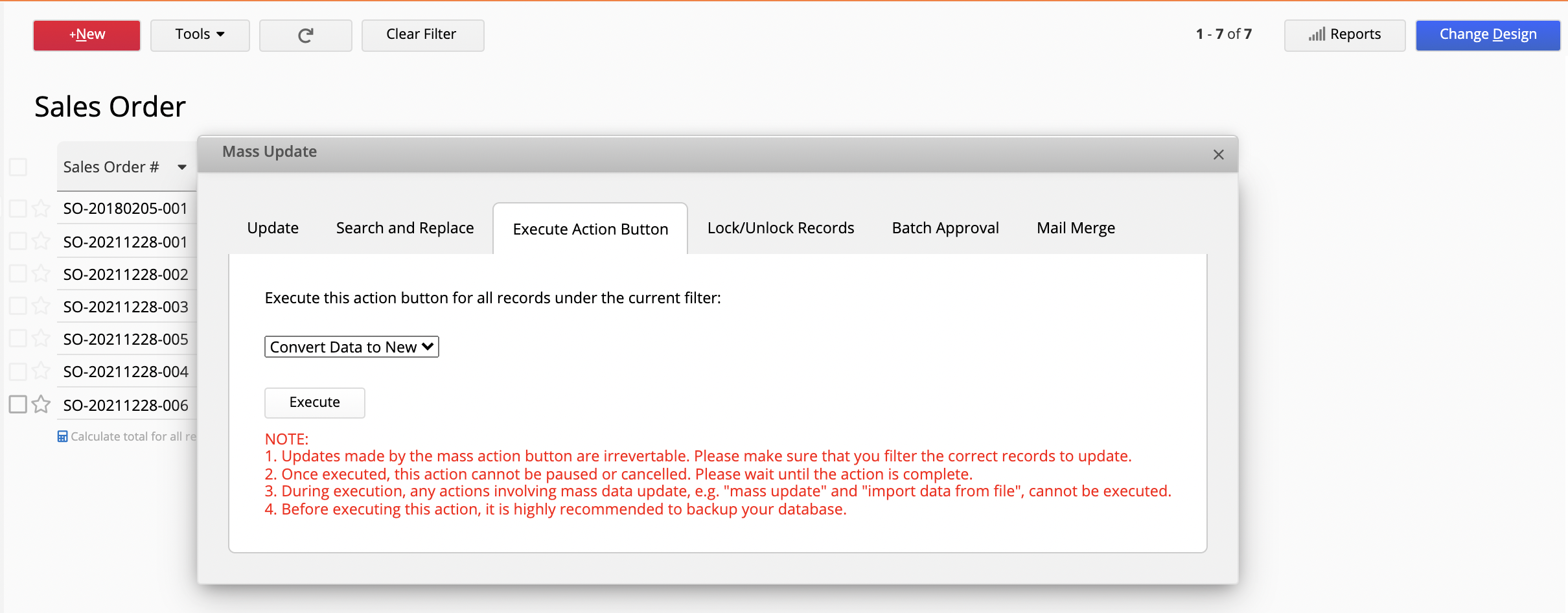

Now, go to the Listing Page of the source sheet. Click on Tools>Batch Execute>Execute Action Button to convert all/selected data to the new sheet.
Go to the new sheet. And voila! All the data is in place.
